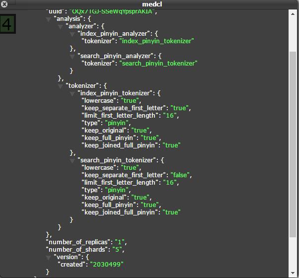

  •  创建index, 并为index设置pinyin分词器, 具体代码如下:
    curl -XPUT http://172.16.0.29:9401/medcl/ -d'{    "index" : {        "analysis" : {            "analyzer" : {                "index_pinyin_analyzer" : {                    "tokenizer" : "index_pinyin_tokenizer"                    },					"search_pinyin_analyzer" : {						"tokenizer" : "search_pinyin_tokenizer"                    }            },            "tokenizer" : {                "index_pinyin_tokenizer" : {                    "type" : "pinyin",                    "keep_separate_first_letter" : true,                    "keep_full_pinyin" : true,                    "keep_original" : true,					"keep_joined_full_pinyin" : true,                    "limit_first_letter_length" : 16,                    "lowercase" : true                },				"search_pinyin_tokenizer" : {                    "type" : "pinyin",                    "keep_separate_first_letter" : false,					"keep_joined_full_pinyin" : true,                    "keep_full_pinyin" : true,                    "keep_original" : true,                    "limit_first_letter_length" : 16,                    "lowercase" : true                }            }        }    }}'

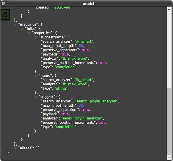

  • 创建3个字段:name, suggest, suggestName,[b]其中suggest和suggestName都是completion类型,suggest字段指定分词器为:index_pinyin_analyzer和search_pinyin_analyzer, suggestName字段指定分词器为:ik_max_word和ik_smart,具体代码如下:[/b]
  • curl -XPOST http://172.16.0.29:9401/medcl/folks/_mapping -d'{    "folks": {        "properties": {            "suggest": {			  "type": "completion",			  "analyzer": "index_pinyin_analyzer",			  "search_analyzer": "search_pinyin_analyzer",			  "payloads": true			},			"suggestName": {			  "type": "completion",			  "analyzer": "ik_max_word",			  "search_analyzer": "ik_smart",			  "payloads": true			},			"name": {			  "type": "string",			  "search_analyzer": "ik_smart",			  "analyzer": "ik_max_word"			}        }    }}'

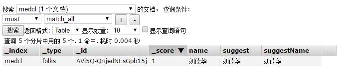

  • 写入一条"刘德华"的测试数据,具体代码如下:
    curl -XPOST http://172.16.0.29:9401/medcl/folks/ -d'{"name":"刘德华", "suggest" : "刘德华", "suggestName" : "刘德华"}'

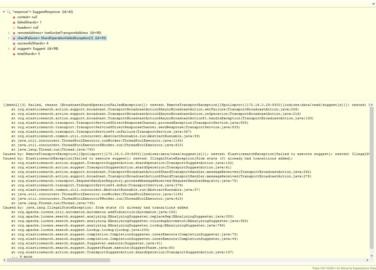

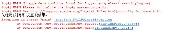

  • 当keyword为"刘德华"时,无结果
  • 当keyword为"liudehua"时,response.getSuggest().getSuggestion("suggest").getEntries()出现空指针异常
    如图:

  补充一下空指针异常的错误,如下图:

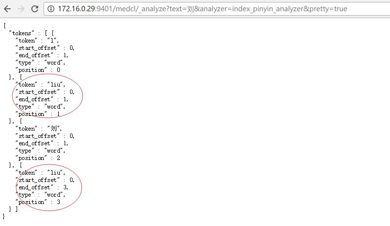

  现在又发现一些问题,不知道是elasticsearch-analysis-pinyin插件的问题,还是我的配置和用法不对。
   结果中出现2个"liu",如图:
   结果中出现3个"liu"和1个"",如图:
   index_pinyin_analyzer的配置请见“步骤”的第1步代码。
